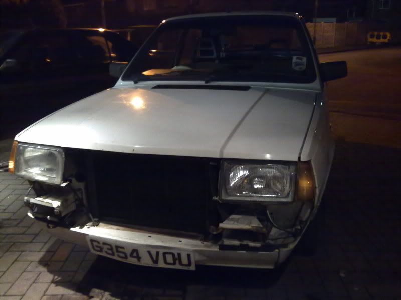

How it has been left for tonight ready to replace the radiator tomorrow morning. First time i've had the front end away and i'm very suprised at how clean and solid it is there, really happy about that :D Also managed to find my missing bumper blank too lmao! It was down the gearbox cooling channel lmao and close enough to grab so I'll have a symmetrical bumper upon refitting :D you can tell the passenger side has had a minor bump, the top bumper mount had bent back meaning the bolt was a pain to undo (I've bent this back though so should be cool :D ) Also the side slide has broke off from the bumper and to stop it sagging they had stuck a screw through the wing into the bumper :shock: I hacksawed through that and will try making something to save the corner sagging down without the need for another very primitive screw bodge! :roll: During that i'll be having a little cleanup around it all where I can!
After fitting the radiator tomorrow all being well i'll be taking Vince down to my friends garage where we'll be taking a look at the carburettor and try sort out my running problem! 340pw

Reached back and began taking the old rad out, the fins were disintegrating as I was moving the damn thing lmao! Not good! Got it out anyway and began to fit the new radiator, my first hickup lol!
It appeared the new radiator (although probably a good thing running wise) was actually double the thickness of my original radiator, bugger! Not a problem though, the rubber bushes the rad locates onto we cut up
We then test fitted the radiator into place which showed it then stuck out too far. We ended up cutting away at the thick rubber block at the back of those bushes until the radiator would comfortably fit into place, sorted :) Because of the extra thickness too, although it probably wasn't essential we decided to move the fan back a touch aswell and used a couple of washers to pack it out slightly, refitted all hoses etc etc with new jubilee clips and bled the system, the fan appears to cut in that little bit earlier now and the engine doesn't get as hot as what it did before when sitting there idling so it's all good so it seems! Job jobbed 340pw
