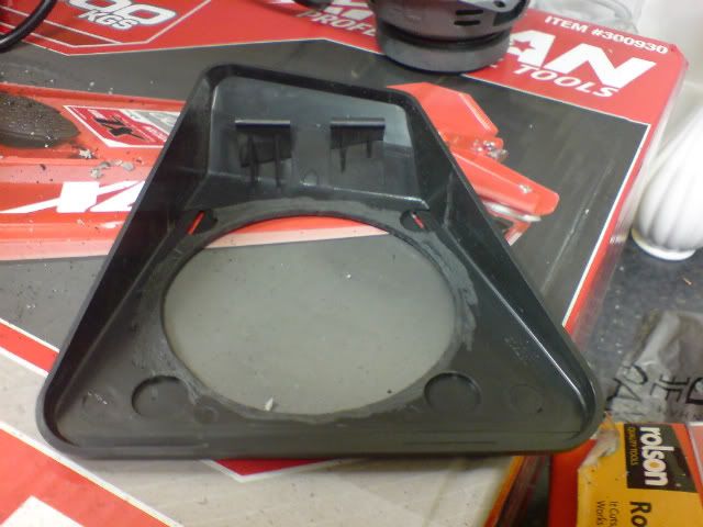

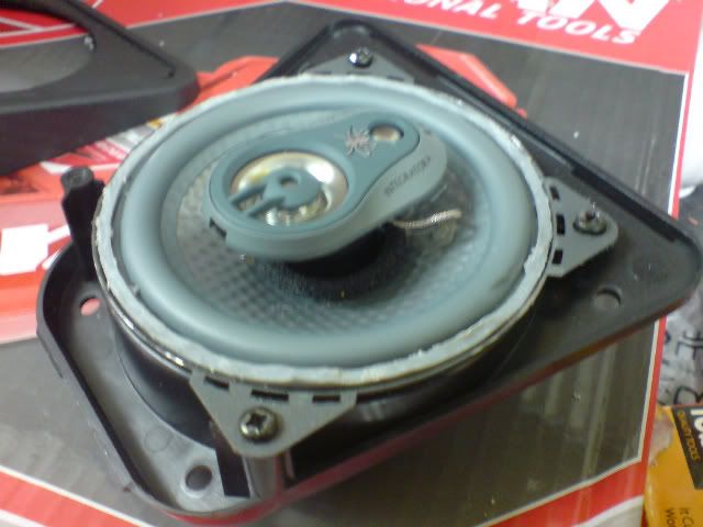

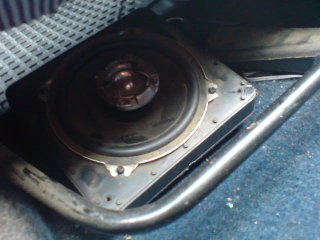

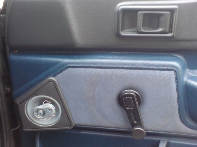

Pointless pics...
Original fitting kit FTW. Have I failed by cutting uncut OMG rare mk2 cards? lol
They weren't a straight fit into the OEM housings. So a little trimming here and there was needed. I will say what has been done incase it is of use to anyone else.
There was a protruding 'ring' on the underside of the cover. You can see where it has been flatted off.
Similar deal for the speakers. The grey outer ring has been ground down to about 50% of the original size to gain the clearance for the covers to snap shut. (yeah it's rough, but you don't see it.)
And in.
The whole setup. :roll: :lol:

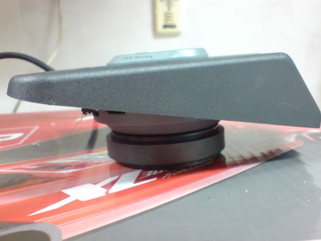

As can be seen, the OEM grilles (or any other) aren't fitted at present. This is because the tweeter protrudes from the speaker pod.
I am going to modify the original grilles so that it clears. I guess I will have to bulge the centre out. I don't want to leave them as they currently are. Stealth is the name of the game here.

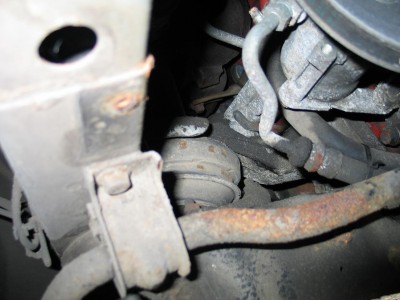

RHS Engine mount + brackets
Exhaust down pipe
It looks like the 940 engine side bracket +cranked mounting might fit with some small trimming of the hat above, but its very close. There is just 25cm in the 360, not sure it would be enough to allow for wobble. There is a angled plate in the 940 at the bottom of the mount meaning the chassis side bracket can be made 90deg.
Hopefully we can share info or do a group purchase. It would be good if we can get drawings for these so >1 can be made.
940 engine mount
360 engine mount
