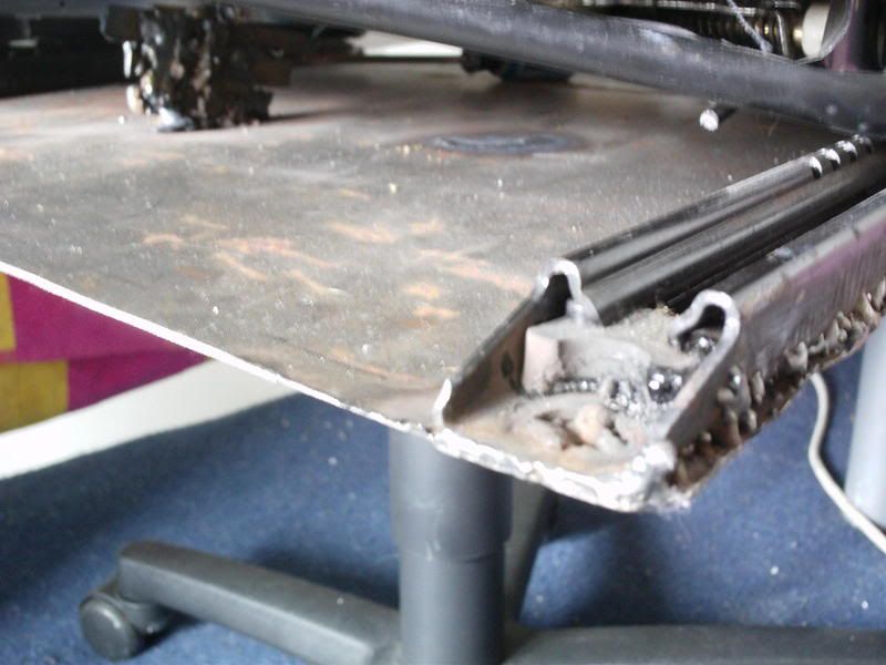

Mostly this weekend I made a man chair.
You can even see where I ran out of shielding gas :lol:

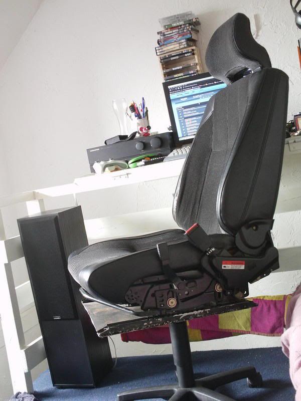

I have to Metro GTA sport seats as pc chairs at home :D Didn't take too long to convert. Managed to remove the seat runners and sell them on and remove the fabric from the rear seat and sell that on too. The seats originally came from a Metro I owned last year; but I took them out to fit MG seats 8) Picture of pc chair below.

Nice! Thanks for the comments. Here's some of the best welding (in the important places):

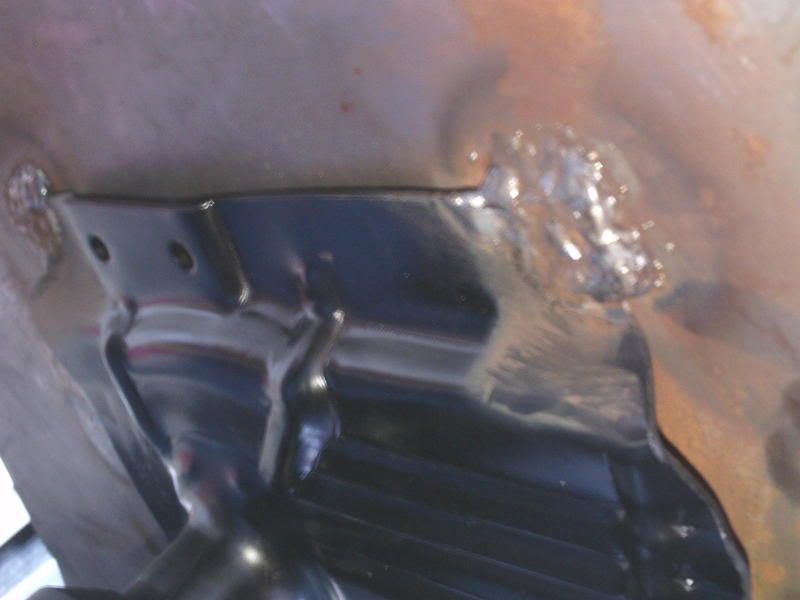

I got this kind of result without gas, when I put nozzle against surface I was working with, tilted it about 45 degrees to right and buzzed just about a second, then moved tiny bit of nozzle and buzzed again and so on whole length of seam. Holes came when I did move nozzle tiny bit too much. I'm not good at all with welding, but found out that such way even I can make working welds. 2nd point I did found out that surfaces must be extra clean, even tiny bit of paint caused popping craclking corn flakes effect that was not nice, underside of that patch is full of that :lol:

yeah that's a good and consistant technique; you're normally able to use a slightly higher setting to get better flow of the liquid metal because of the really short welding time
i'm surprised you can get this quality welds without gas! the section on the right side of the pic is flawless, as you said; cleaned surface and steady movement of the pistol is key to do this

That must be said that I did have gasless welding wire, costs a lot, but not as much as gas over here, that is unless you can get somewhere old bottle and know right people, when gas is cheaper.
I think that quick is good, usually I started next spot while last one was still red. I did not use mask, well kept it on hand and moved it to cover most flying melt metal, but there is not much point trying to look welding when doing such sort time welds, it is same to use some metal sheet as a mask, imo.
