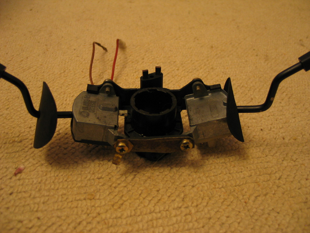

Ok Guys, it turns out to be the design of the `stalk` mount, you will see by the pictures that there are two screws to hold the stalk steady, but the problem is that these screws are a kind of swivel action in that if any one of them becomes loose then the switch/ stalk swivels as the arm is pulled towards the driver to flash or dip headlights :? . The bottom screw is the one that acts as the `ground` anchorage, so it stands to reason that the contact to ground becomes U/S as in my case :x This design also makes the Top screw impossible to get access to....I wonder how many guys have had this happen over the years ?
My modification was to drill a hole in the cluster facia so I could gain access the top screw. All tightened up and everything is back to normal with loctite applied to both screws :) I also was able to apply some silicone grease to the nylon indicator `knock off` arm as an added precaution to future wear problems :)

Post by Ride_on »
Yes the whole collar + switch unit slides off once you remove the steering wheel. There maybe a little plastic stud aswell.
The top bracket should stop the switch from rotating too much, usually what happens is the bottom screw hole breaks out because it is thinner on the left hand side. A metal plate with 2 holes in it provides an robust repair.
A general tip is to use fingers to control the stalks rather than hands. My mate went through a few collars and I noticed he used his hand quite often on the stalks, when I only use my fingers. Sometime the top one goes aswell.
Here's one I repaired.
Repaired stalk mount
