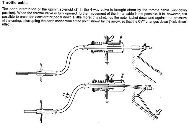

Now, lol where is the kickdown switch located? Is this the connection that is on the carb by the throttle stop or is it located near the pedal end? A photo would help as I can't tell from the guide what this item looks like.
Re: Variomatic query 1986 Mk3
It's on the bulkhead (on the inside near the top of the pedal) - haven't got a photo but hope the attached diagram helps.
