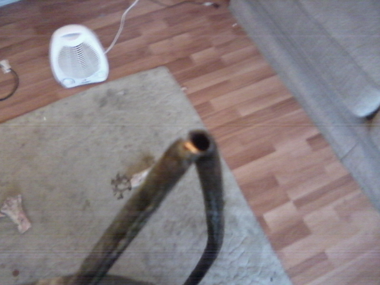

I have removed the rear brake pipe, I agree with the MOT man, it is unsafe... now, it being legitimately duff, instead of sanding it down, and applying filler+paint, do a real nice job on it lol..... I'm going one better and getting one made.
I've measured the length at 3m 17cm, I need to know what gauge pipe it is and what type and size of connectors so I can order it to be made up without a. driving with no brakes, tax or mot- or b. cycling in snow.
cheers.
edit: on rolling up the pipe into coil this happened- :o
