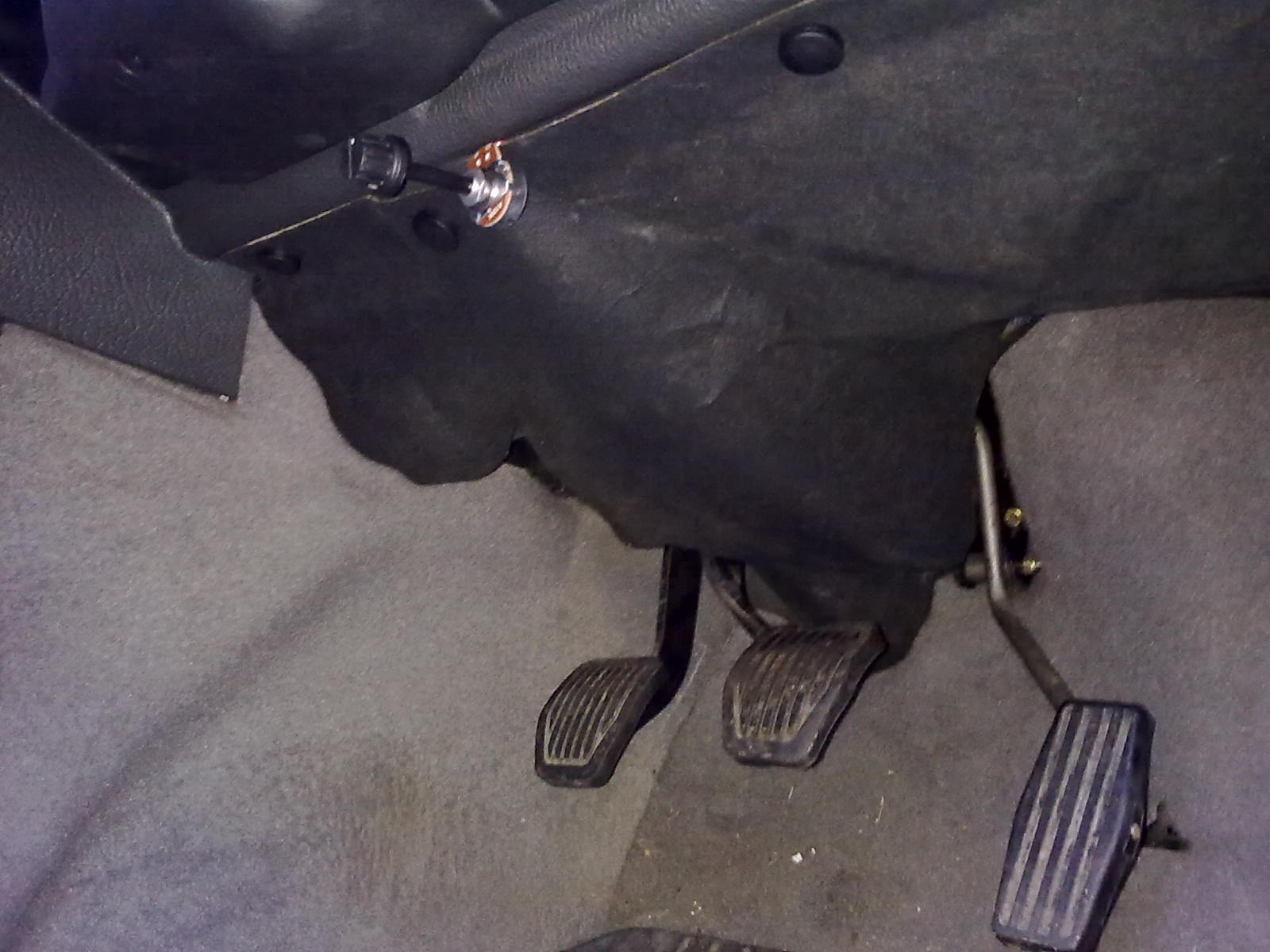

A bit of bathwater being used to re-shape the underdash trim panel...
... hopefully to get a good-enough fit.

I have indicated how the wiring goes from the battery via a fuse, as shown lower down.
All else seems to be fine and the trim parts have been refitted but I must remember to refit the clip to the brake servo vacuum hose.
The setup still seems to work fine so attention will turn towards the rear, nearside spring which seems a bit saggy, as well as the front seat belts which don't retract very well.
