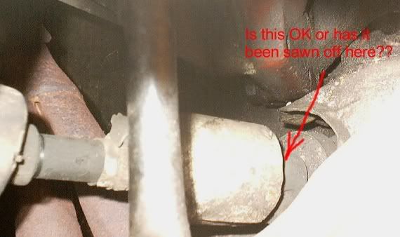

Hello, here is the steering column heat shield which I posted a year ago or so and members assured me it was OK.
Cheers, bogbasic.

As Bogbasic says, that heatshield as well is something to remember. The main problem is how different things are for a LHD car, as I doubt you have to worry as much about the downpipe clearing too much.

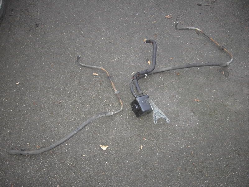

I can't seem to find the rack at the moment, it's here somewhere, I'll be moving more stuff at the weekend. I'm sure I hid it somewhere in the dry! Anyway, found the PAS revervoir and associated pipes.......
Pete
Post by trabitom99 »
Thanks for those pictures Pete, they're a great help! Good of you for taking the time to post them ...
