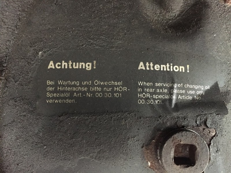

Tiny Update: after two years of resting (other f***ing projects reqruiring all my spare time) I have managed to get her back on the road, and to participate in one GLP on the Nordschleife - in the dry - Yeehaw! Lots of fun, even if i had to use my "wet-Options" uniroyal Rain Sport in 175/70/13 in the dry (don't ask... seriously woobly sidewalls..turn in, and wait.... oh, is something happening? Every corner required stragical planning)
On the upside... apparently there's a LSD on my 360. I had never bothered to check before, because they are so rare and the car has always been a pensioner's first choice, being despoilered, debadged and de-decaled... but the rear wheels only turn into the same direction, and there is a sticker on the gearbox that I have ignored before (see below...) So apparently its a clutch-type Hör Diff :D
Diff sticker Hör
Diff sticker Hör
And a clutch-type LSD does explain her peculiar behaviour - seriously tail happy in the wet, and a tendency to suddenly snap into turn-in in the dry, when the clutch-type LSD abruptly opens and she increases turn in. What a bag of surprises this "343-500" has been ;-)
I am still waiting for confirmation from Hör, but apparently there's nobody left who would know anything about their 80' products...

That's amazing news, what a surprise find! HÖR LSDs are extremely rare. AFAIK only the Swiss "RSX-2"s had them as standard. Did your car originally come from Switzerland?

I think the car has first been sold by Auto Gerb in southern Bavaria. Fahrzeugschein and Fahrzeugbrief are as I would expect for any german Erstauslieferung, but I am not too sure what the signs would be (other than lots of zeros for reimports). Do you know any give away?
The car has been built in 1986, is MY 1987 and has first been registered in 07/1987. So far I am guessing that Auto Gerb specced the car (for some reason including the LSD, maybe so that it's really sporty and appealing to young hotshots) and then had it sitting in the showroom for ages. Then Mr. 100 years old lurches into the showroom, says: I like that car, but all that bling is not appropriate. Far too revolutionary, especially that spoiler! While you're at it, drop the decals, and those wheels are far too sporty for my wife!
Since the car had not shifted in a year, Auto Gerb was only too happy to oblige. But that's just guesswork ;-)

AFAIK, limited slip diffs are ordered quite a lot in alpine areas too. So if it originally came from southern Bavaria, that could be a clue.
Good find, anyway!
