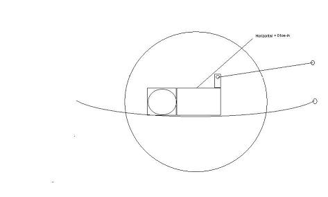

I'm not sure if reaction rod is the right name, it keeps the axle at the right angle as it moves up and down. Because the axle is fixed and wants to rotate as the spring compresses, it needs angle controlled to stop the negative camber turning into toe-in. Toe-in is very bad.
I think the mods will increase the length requirement of the rod as the axle is moving away from the spring and we now have less paralell arms, so I'd say it will tend to be adjusted towards the front of the car, but you are aiming for a level box section.
I'd suggest putting the car on axle stands under the jacking points (making sure car is level) and putting a trolley jack under the axle. Then raise or lower it until the axle box section is level, then clamp up the radius arm. If the bushes are worn/distorted they may relax when you release it, you need to renew or change to a rose jointed arm, or you might find the standard rod is not long enough.

I'm not sure what you mean but you are not positioning the axle in the front-back direction with the rod. The axle should be bolted securely to the spring and centred properly before you attach the rod. I'm not sure how well the lowering blocks achieve centring, but they should replicate the locating boss from the spring.
The rod adjusts the rotation of the axle (in the same axis the wheel rotates). The axle has negative camber in the vertical direction and needs to be kept flat so the camber does not turn into toe-in.
The axle is solid, rotation on one side will translate to rotation (or lack of) on the other side.
The rod adjusts the rotational position.
