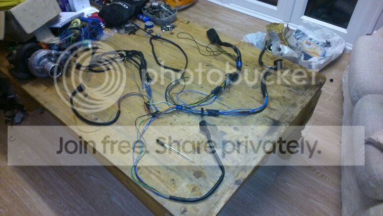

ive recently shortened LE my loom (the AMM and relay sections have had at least a meter lopped off), here it is in its entirety on my conservatory table
from the ecu plug going clockwise its; main relay (2 wires for renix above), AMM at the bottom, throttle butterfly switch, injector and CSI stuff, water temp stuff, earths and not a lot more ... only 13 wires to the ECU
this looks like childs play compared to LH2.4
the rest of the engine bay loom in my GLT is just for lights and horns as far as i can tell
this is UKDM stuff, downunder/NZ spec might be different..... EGR nonsense is fitted to most 200e's down your way iirc so who knows what else you might have

Haha, I just though the exact same thing. The wiring harness also weighs half as much as the lh loom.
