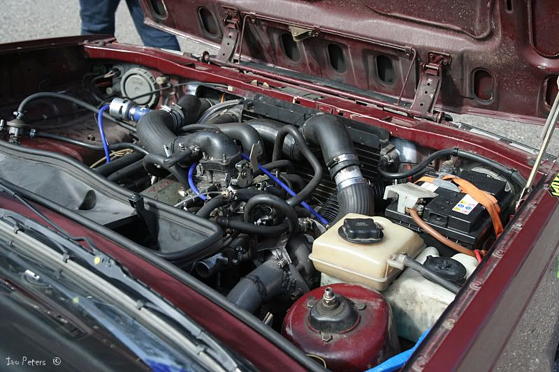

Dai, you are right
a pic of the 340L from frits;
this shows that with the current exhaust system, te turbo downpipe will fully penetrate the headmastercylinder.
hmm. various thoughts about the rhd cross my mind. i could still convert it to a lhd but that also means a bit of extra work.. moving the turbo won't be an answer, can't move it too far forward. then it's stuck messing with the waterpump.
