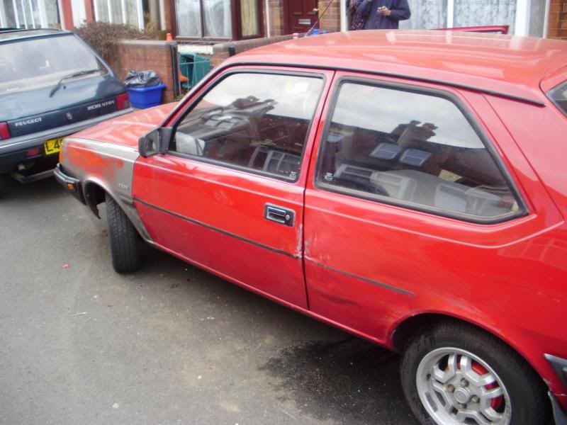

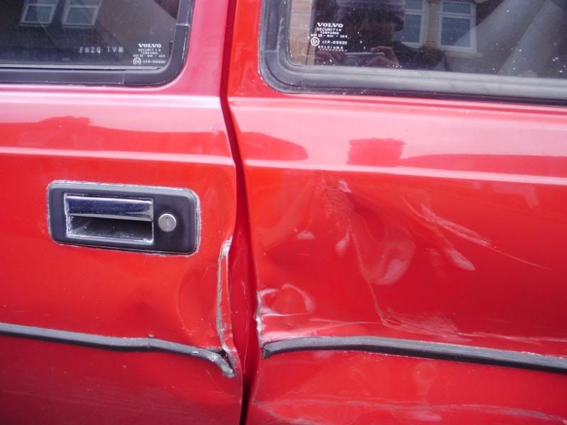

Got to work on the car today at 8AM this morning,with alot of help from my minions .After a lot of hammering and unblolting, and a lot of swearing these are the results,The car is now ready for a touch of filler etc.I removed the plastic body strips from both sides now as I dont think new one to replace the damaged one is available.Although My panel beating skills are non existant ,I think I done pretty well straightening the door edge out and bringing out quarter panel.What you think?

Oh boy, there is quite a lot of panel beating, they hit it quite hard :shock:
Progress looks great :D

LOL Tom,I just couldnt see the dents on car ,hence i didnt take nay pics of damage as it really wound me up.Asked number 2 son for hellp and he was more than happy to help,Roger pulled out his cleaning cloth told him no matter how much he cleans the damage is not going to go away :)

Nice to see you are getting some good progress with it. The damage is quite bad but at lest it is repairable.

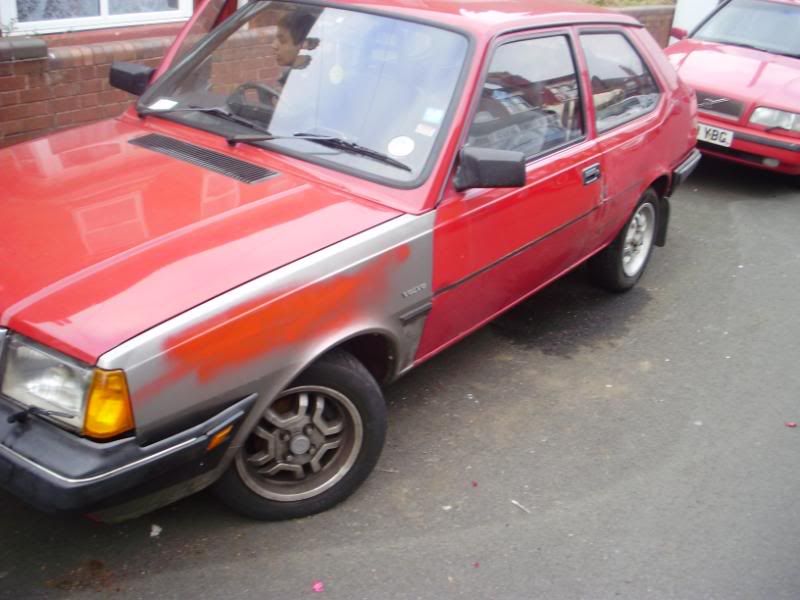

Hi Guys,Progress on Tiffany has been very good so far,Every bit of time i get ends up being used on getting her back togehter again,Done some filling in over the last 2 days,I am trying to use as little filler as possible.So far the results are pretty good for my first ever attempt at bodywork,managed to get body contours just right,Now waiting for next bit of time to start sanding down the filler and apply so knifing putty.However I see getting the paint maybe a problem as so far I cant find any Volvo Bright Red (231) paint.You guys know anyone or anywhere that sells paint for 340?If I cant find any spray cans then I may leave car until summer and opt for the full respray option.

Code 231 is the same as my GLi ! Volvo may still sell it, you never know, it was quite a popular colour. My local car spares place still stocks it, the paint match was good (which is more than can be said for the recent Halfords' effort :-()
