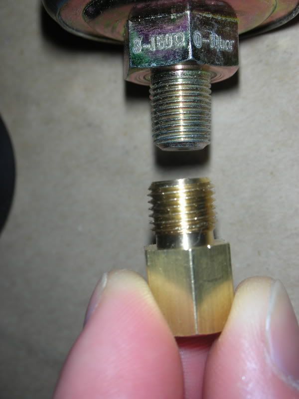

Good to know before i went and "made" it fit in the hole then. Being foreign made gauges the instructions are in English but are minimal to say the least, the wiring bit is fine, but the sender came with what i think may be an adapter?
It screws onto the end of the sender and i think the thread is different, although not 100% i'll check it with my thread checker if i can find it. Only thing is it doesn't seem like a very good fit onto the sender, other than that i can't see what its for.
Anyway a pic will probably explain it better than i am:
So the end i'm holding will screw onto the thread on the sender.
kaos
Posts: 1298
Joined: 09 Jul 2007 10:34 pm
Location: Somerset
Re: Oil pressure/temp senders, where on F7R
Post by kaos »
thats just a minimal change are you guages auto gauage by any chance?
i have the same set up for all of mine. merlin i think sell the m14- 1/8NPT at £5 odd.
that should be all you need it may be a bit tight though down on the oil pump side.
