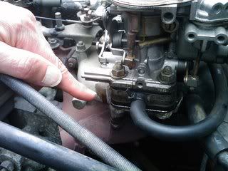

Can somebody tell me why I need that black hose.What is purpose?
thanks
Re: How Many Gaskets Do I Need For A Weber 32DIR Carburetor?
Post by volvodspec »
if you have a healthy engine you don't need that hose, if you block it and you also block the connection at the breather t-piece only possible problem is that there will get oil in the airfilterhousing with a not perfectly healthy engine.
the hose itself has a restriction in it, this is very important to keep the engine running properly!
