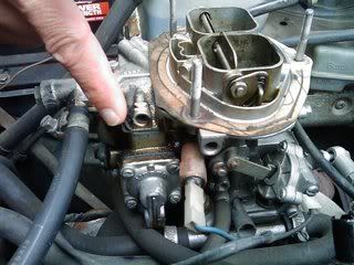

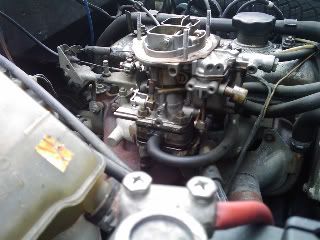

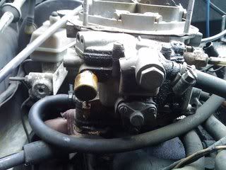

on your pics, i can clearly identify the list as above.volvodspec wrote:from manifold to carb:
- gasket with oval hole
- 5mm black filling plate
- carb heated base
- multi gasket (thin cardboard-piece of plastic about 4mm thick-thin cardboard) 2 holes in it
- base of carb
at your third pic just by your fingernail is this gasket, take off the paper gasket at the top of the carb and you will find 5 screws to bolt the floaterchamber cover to the carb base, retighten if they are loose.volvodspec wrote:there's another gasket, for the floatercover. a very important one aswell, if this gasket strucks a leak very weird things kan happen...
also at the third pic, about 3cm lower than your finger you will find the acceleration membrame, the cover of it is bolted on with 4 screws. if you repeatatly apply throttle, see if any petrol leaks down from it.
at your first pic, 2 of the 4 nuts for the carb base are to be seen, are the 4 nuts still tight?
if you remove the carb for new gaskets, make sure to check if the base of the carb heated piece is as flat as a mirror.
Re: How Many Gaskets Do I Need For A Weber 32DIR Carburetor?
IS THE BASE OF THE CARB THE PART THAT IM POINTING TO IN PICTURE-1? IT HAS A BLACK PIPE EMERGING FROM IT, BELOW THIS BLACK PIPE IS WHERE I HAVE PETROL LEAKING WHICH YOU CAN SEE IN THE PICTURE AS IT'S VERY WET. THE PART I WAS SENT TO REMEDY THIS PROBLEM IS CALLED A FLANGE GASKET/INSULATOR BLOCK. AS YOU CAN SEE IN THE PICTURE THERE IS ALSO ANOTHER ONE ABOVE THE BLACK PIPE.
IS THE 5MM BLACK FILLING PLATE YOU REFER TO NEARER THE TOP OF THE CARB?
ALSO WILL I BE ABLE TO REPLACE THE FLOATER COVER GASKET BY JUST USING A UNIVERSAL 1MM GASKET?
please dude, turn off the caps-lock..
the piece that that black pipe comes from is the pre-heating block. it is called this way since there are 2 coolant hoses on the other side of the carb wich heat/cool this piece to keep mixture from freezing. the black pipe however is connected to a tiny channel connected to the inside of the base, where it gets vacuum from the engine. the black pipe is connected to the crankcase breather t-piece.
below the pre-heating block, you have the bigger 5mm block with a gasket on each side. these gaskets can easaly be copied with universal 2mm thick gasketpaper. these are simple, just 4 bolt holes and a big oval hole in the middle. the 5mm thick black insulation plate will only need replacement if it is broken or cracks are visible.
but however, this is a very strange place for the carb to "leak" petrol, since at this point the mixture is subjected to full vacuum and will only get sucked into the engine, not blown out..

the 5mm block i was sent has already got the gasket attached either side of it. my old one must be cracked for it to be leaking unless the four bolts aren't fully tightened which i'll check tomorrow.
what size is the slightly thinner block above the black pipe on the pre-heating block, 3mm?
i was just going to replace the 5mm block where it's wet until a friend said i might aswell rehaul the entire carb whilst im at it.
i just need to know exactly what i will need to do this as it appears the company im dealing with doesn't supply all the necessary parts in their kit.
the following is what they do supply:
1.Top float chamber gasket
2.Throttle body gasket
3.Needle valve & seat
4.Filter
5.Mixture screw
6.Accelerator pump
7.Choke pull off
8.Enrichment valve diaphragms.
The flange gasket/insulator block gaskets are not included.
