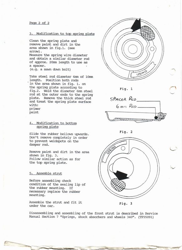

That's very interesting! My 360 GLT has fits of making this noise, then goes quiet for ages, then decides to start again. That's exactly what we decided it was (Pettaw and I) and didn't know whether to go for the, it should move so lubricate it to stop the noise, or it needs clamping to stop it moving route! I couldn't really see how it was wear on the 360, due to the lowish mileage. Good info, cheers.
Pete
Originally problem comes from top bearing support thing (that triangular rubber) being cracked due age, so it is not bearing that carries suspension weight but top spring plate. Now when you attach spring to those cups/plates to stop them rotating, steering might get somewhat heavier at times.
