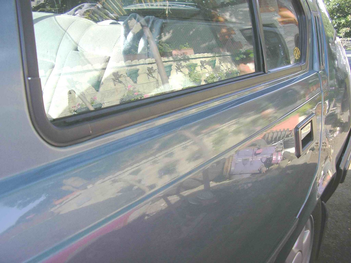

I've been fed up with the state of the door seals (window scrapers) on my 345 for ages now.
So I phoned the volvo dealer for a price (needed a windscreen rubber at the same time) and at £8 each you can't complain for genuine parts.

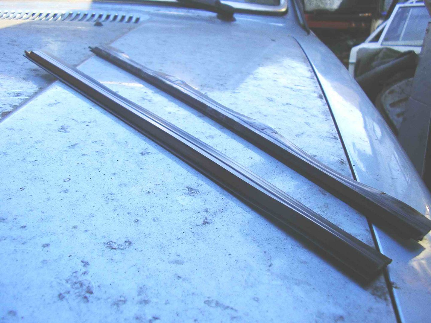

All you need to do is pull up on the old scraper, you may need to use a screw driver.
Then cut the new seal to the same length as the old one then just push back into place.

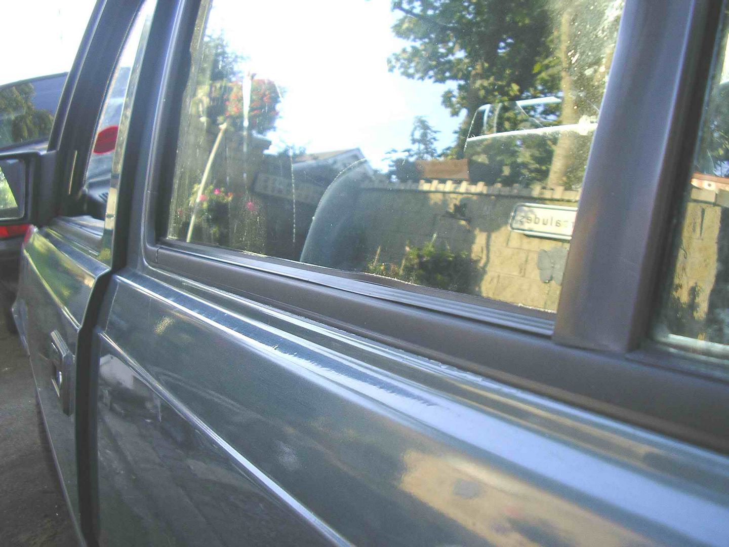

I think for £32 its well worth it to stop the doors rotting out, and they look a lot better.
