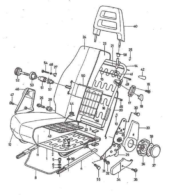

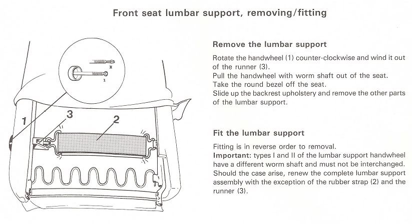

Lumbar controls - two main problems - both easy to fix.
The lumbar control wheel is fitted with a threaded fod which engages in a nut in a support cage. The lumpar support itself (an oblong rubber sheet - ooooh! I like it) is fixed to the nut and secured to the frame on the other side, such that turning the control tightens of loosens the support.
The first problem is people undoing the control too far - the nut falls off the rod. (rod has a splayed end that should prevent this but doesn't).
The second problem is the fixture on the opposite frame - it is a bent over tongue welded to the frame tube, over which the lumbar support hooks. It simply becomes un-bent !!.
Fix for both is to remove the hog clips securing the backrest upholstery (they are bent metal rings that trimmers use) and lift the cover up to expose the mechanism (lifting and exposing - oooh again !!).
Then either re-connect the nut and rod or hook the support back on and bend the tongue back over.
As for the heaters again two problems - either the thermostat fails, or, far far more common is the action of a squirming bum scrunches the heater element on the seat squab up (it's just a 'snake' of heating wire in a plastic mesh envelope) and it overheats and burns out. Repair means upholstery off and replace whatever has failed. (if you can still get parts) almost certainly not worth the bother.
All of the above problems are far more common with the 'portly' driver (fat like me !!)
The pics below should make things clear.
Mac.

Mac, thanks for that, I'm about to get stuck into fixing the seats I want to put in Fake, that diagram is just whats needed!

Hmmm, very useful diagrams there, I now can directly link to the exact part that suddenly felt slack! The two lumbar support knob have both broken in exactly the same place, before I got the seats, but the lumbar support was adjusted to my liking. First problem is, as I thought, being the leather, the control wheel is black, not the common grey! Making finding an intact one for a donor somewhat difficult. I thought the actual screw thread went most of the way across the seat, but that shows it clearly doesn't, so the broken bit is relatively short. The thing has broken on the plasic just where the thread starts when it gets thin and there are the two grooves in the plastic. I might try and join a good one with my black wheel.
Now I know a bit more about the internal workings and can see inside I might have a go at this and Adam has offered to help me if I make it along to the BKV.
Pete
